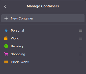

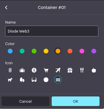

4. Click “New Container” at the top, give it a Name, Color, and Icon, then click “OK”.

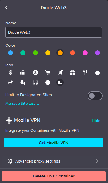

5. Click the name of the container you just created (in my case it will be “Diode Web3”).
6. Click “Advanced proxy settings”

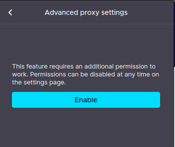

7. Click the “Enable” button

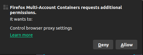

8. Click “Allow”

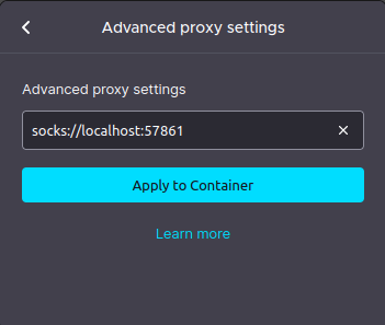

9. Insert socks://localhost:57861 into the “Advanced proxy settings” field, then click “Apply to Container”
10. If you’ve done everything correctly, you should see socks://localhost:57861 shown under the “Advanced proxy settings” section, as shown below.
